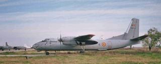

#33 Useril este offline   deltadagger
  • Postari: 479
  • Inregistrat: 21-November 09
  • Interests:Aviatie
Postat 14 April 2015 - 07:19 PM
AN-24T "1801".

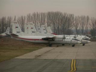

#37 Useril este offline   Romi
  • Postari: 1941
Postat 14 April 2015 - 09:07 PM
1801+1802
  • Imagine atasata: 1801-497723.jpg
