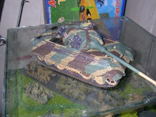

Postat 06 May 2008 - 05:21 PM
sint 2 modele la 1:72 si 1:35Imagine atasata: SANY0005.JPG
