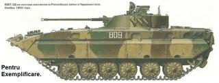

PENTRU CAMUFLAJ RUSESC STANDARD (VERDE+gALBEN+NEGRU) BAIETII DE LA TRUMPETER RECOMANDA:
VERDE:MODEL MASTER 1713 SAU TAMIYA XF-20 SAU HUMBROL 117
GALBEN: MODEL MASTER 1706 SAU HUMBROL 121
IN AFGANISTAN FOLOSEAU FIE VERDE FIE UN CAMUFLAJ BICOLOR CU UN FEL DE GRI GALBUI(GRI-CREM DACA VREI) DAR NU STIU SA -TI SPUN CE ECHIVALENT AVEA.
AM GASIT IN SCHIMB ACEST PROFIL CU UN BMP-2D DIN TADJIKISTAN ,1993.CULORILE SUNT CELE DE MAI SUS ,CAT DESPRE MARO ...MA TEM CA NU POT SA SPUN PREA MULTE.
CE POT SA SPUN CU SIGURANTA ESTE CA NU VEI GASI DOUA VEHICULE CU ACELASI MODEL DE CAMUFLAJ IAR DE MULTE ORI SI SPECTRIUL NUANTELOR ESTE DESTUL DE LARG.
SPER SA TE AJUTE.
ROMEO
