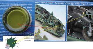

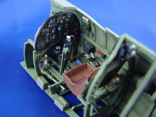

Intradevar, se vede in poza ca scaunul e vopsit in Cockpit green 78, dar restul nu prea seamana, mai degraba aduce cu interior green, al americanilor. In realitate e mai asemanator decat in poza. Poza de pe cutie arata doua feluri de verde iar Tamyia si Hasegawa dau doar o singura culoare. Cam coplicat pentru ca prin forumurile straine am citit ca e kitul cu cel mai detaliat cockpit si as vrea sa-l fac frumos.
  • Imagine atasata: 6027.jpg
Aceasta postare a fost editata de DGDaniel: 26 December 2009 - 12:20 PM
Postat 26 December 2009 - 03:34 PM
Nu te mai inspira din pozele de pe cutie, ca oricum vopsirea e sa fie, numai corecta nu.
Acel Humbrol pare relativ OK, insa nu-l am si nu pot sa zic clar. Insa se apropie de culoarea de interior britanica.
NU incurca cu Interior Green-ul american, ca asta-mi pare ca ai in poza de sticluta. Cel american n-are nici o legatura cu cel britanic. Da' chiar nici una.

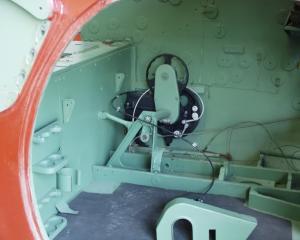

Iar ma repet, parca ar fi Interior green de la americani.

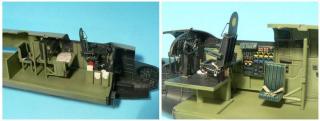

Poza este de pe http://aeroscale.kitmaker.net/modules.php?...&artid=2915 cu un Lancaster.
Si am mai gasit asta fe un forum strain
"Without finding the specification requests, for each, and every, airframe, it will be difficult, to say the least. The spec., for what became the Spitfire and Hurricane, called for a grey-green cockpit, but the S6B already used that colour, as did the Walrus, so it's possible that Supermarine had used a green for years. The Gladiator had a green cockpit, but the Bulldog (and the Fury) did not, while the Hart did. The Spitfire had a green cockpit to the end of the 24 production, but the Seafire (partially in the 17, totally in the 47) went black. The Typhoon and Meteor had black cockpits before the end of the war. It's possible that the Spitfire was always viewed as a day fighter, so kept to a green, while the Seafire, Meteor, and the Typhoon were viewed as possibilities for night operations. Then, of course, you have the Mosquito, which was used as a night bomber & intruder, but always had a green cockpit. The change from black to grey is fairly easy, since it was with the Lightning, either the Mark 2, or 3.
I've just read over this again, and I'll be amazed if you're not as unsure as before; I wrote it, and I'm confused!
  • Imagine atasata: Interior_Lancaster.JPG
Aceasta postare a fost editata de DGDaniel: 04 January 2010 - 07:26 PM

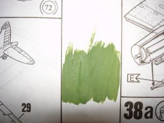

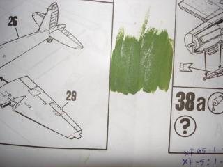

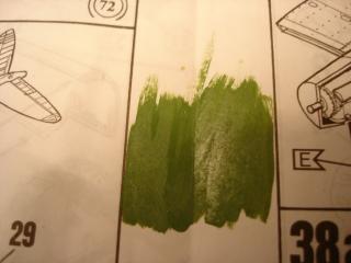

O reteta ochiometrica pe care am folosit-o in trecut: 1 parte green zinc chromate de la MM + 1 parte medium grey de la MM. Iese cam pe-acolo, n-o sa te verifice nimeni cu nuantierul, decat daca respectivul are o viata patetica si plictisitoare.

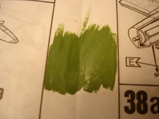

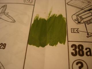

Super, :hug: :whistle: :hi: :wacko: :bang: am ambele vopsele, le-am combinat si vedeti ce a iesit (am facut pose cu/fara blitz)
Si ultimele trei poze, de pe net, cam seamana
Daca primesc unda verde ma dau la vopsit.
Multumesc

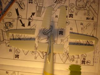

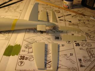

Intre timp sa va prezint ceva puntin ciudat despre acest kit: tot ce inseamna suprafata de control este mobila, adica nu detasata sa o montezi cum vrei ci mobila in adevaratul sens, Revell a facut fiecare flaps, eleron, profundor si directia cu mici balamale. Culmea, miscarea flapsurilor e permisa doar in sensul corect, adica nu se dau peste cap.
In total in cutie sunt cam 150 de piese, iar o chestie ciudata. Nevasta ma vazut cand l-am desfacut si m-a intrebat cate avioane fac dintr-o cutie doua sau trei.
Concluzie, este un altfel de Revell :hug: , un Revell la care pana acum nu am folosit putty, un Revell care imi place.
Oups, se vede in poza ca profundoarele sunt diferite, adica pe unul se vede chestia aia care misca trimerul si unul nu, asa erau in realitate sau e gresit kitul care tocmai l-am laudat
  • Imagine atasata: DSC06072.JPG
  • Imagine atasata: DSC06074.JPG
Aceasta postare a fost editata de DGDaniel: 05 January 2010 - 06:36 PM

Pai culoarea fa-o sa semene cu ce-ai vazut in pozele alea trei. Nuanta obtinuta n-ar trebui sa aiba tenta oliv, cum apare in multe din pozele tale... Eventual, creste procentul de gri din amestec si vezi ce iese.
Nu stiu la Mosquito, dar sincer ma indoiesc ca e gresit. Am vazut si la aviatia de azi, trim doar pe un semiprofundor. Nu e nevoie pe amandoua, roll-ul dat de trim fiind minor. Plus ca sincronizarea celor doua trimuri ar fi prea complicata pentru un job asa de simplu. Inclin sa cred ca asa era si la Mosquito.
