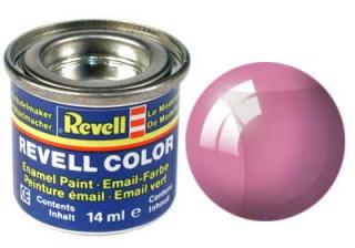

Postat 10 February 2005 - 11:25 AM
Poate ti-ar trebui ceva in genul: 32731 rot, klar 14 ml-Dose oferit de revell ?
Nuanta insa e cam roz inchis ...
  • Imagine atasata: 32731.jpg

Sau Humbrol 1321 clear red. Dar nu cred ca are mare diferenta de revell.
