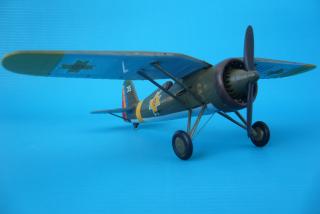

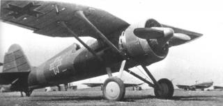

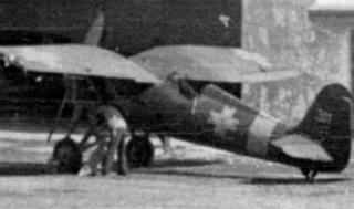

Postat 15 March 2006 - 06:55 PM
Pzl 11C
  • Imagine atasata: PZL11C_001.jpg

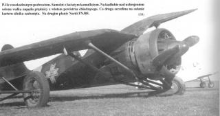

Postat 15 March 2006 - 06:57 PM
Pzl 11C
  • Imagine atasata: PZL11C_0044.jpg

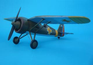

Postat 15 March 2006 - 06:59 PM
Pzl 11C
  • Imagine atasata: PZL11C_0033.jpg

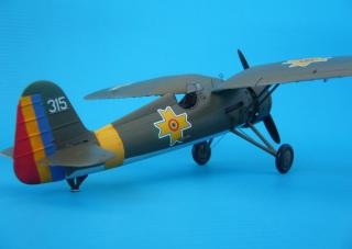

#13 Useril este offline   Cantacuzino
  • Postari: 717
  • Inregistrat: 22-February 05
Postat 15 March 2006 - 07:00 PM
Pzl 11C nr 315 zburat si de bunicul lui Grek :-D
  • Imagine atasata: pzl_11C_nr._315.jpg

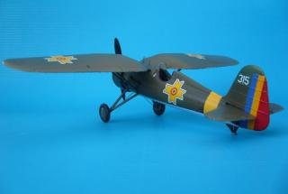

Postat 15 March 2006 - 07:02 PM
  • Imagine atasata: 08_09_43_Ghimbav_.jpg

Postat 20 March 2006 - 11:40 AM
In poza cu 315 mi se pare ca ar fi bechia rupta sau infundata in pamant.
L-o fi stricat bunicu? :-D
Tare m-as apuca de macheta asta.............sa i-o fac cadou lui bunicu.

#19 Useril este offline   Cantacuzino
  • Postari: 717
Postat 20 March 2006 - 12:48 PM
Dupa cum este de mic in cabina lui 315, pilotul ar putea fi Popescu Greaca. :-D
